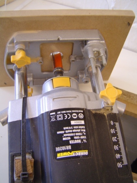

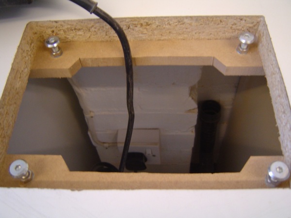

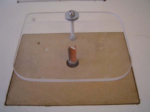

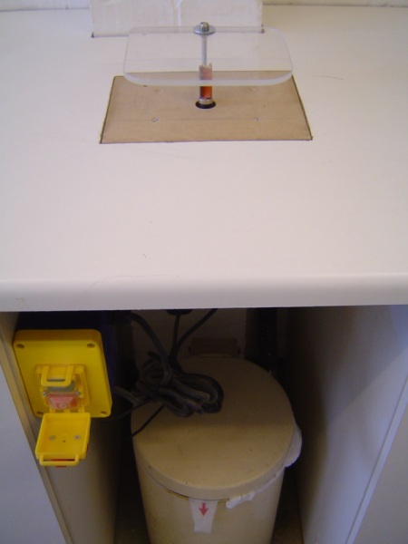

When it comes to tooling for the non-production builder I'm in the keep it simple school. I built in my own table system into the workbench top. It is in the top three most used tools I have (Drill press, Bandsaw).
I level the insert using four, screws and inserts, the same ones I use for neck joining, but with a locking nut.
I don't use a raiser as I think that is overkill for the amateur and low production builder I just lift the whole thing out and set the depth as I would normally.
I think the whole thing took me about an hour to put together. It has been used for making all of my moulds and bending forms, bridges etc using a pattern bit and of course gets used for cutting truss rod and CF slots in the neck.
Keep it simple, less to go wrong and you can spend the money you saved on more wood!

My "router table" looks a lot like yours, Colin. My router (2 HP Bosh) is attached to a 5 mm steel plate that is inlayed into a 40 mm Formica topped bench top. I clamp the whole arrangement to my woodworking bench when I need it.   It is very sturdy, and I have no desire for a more elaborate table, except I will build it into a more permanent system once the new shop extension is done. I do have an old huge, monster shaper with something like a 10 HP motor in parts somewhere in my garage. It was so cheap I could not afford to not buy it when a local cabinet shop was closing down, but I have no idea where to put it (or how I am going to move it, the seller used his tractor to load it onto my poor trailer...). Perhaps if I start making solid bodies it will come in handy, at least that is the story I stick to when my wife asks about it.
